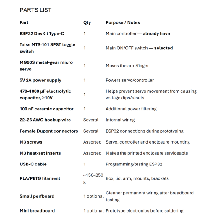

I’ve been into 3D printing for a few years now, and I’ve picked up a decent amount of 3D modeling along the way. I’ve also dabbled in coding, but I’ve never really had a project that forced me to put all of those skills together. So I decided to build something completely unnecessary: a Useless Box. 😂 The idea is pretty simple—a box with a switch that, when you turn it on, has a motorized mechanism come out and turn the switch back off. It serves absolutely no useful purpose, which honestly makes it the perfect project.
What makes it interesting to me is that it gives me a way to dip my foot into programming without jumping straight into something overwhelming. I get to combine the 3D modeling and printing skills I already have with learning how to program a microcontroller, control a servo motor, read a switch, deal with timing, and eventually make the thing actually behave intelligently. Instead of just writing code that prints something on a screen, I get to write code that physically makes something happen in the real world. I think that makes it a pretty good way to break the ice with coding, electronics, motors, and all the little problems that come with making hardware and software work together.
The plan is to start simple, get the basic version working, and then keep improving it. I don't want it to do the exact same thing every time I flip the switch, so I'm already planning different random behaviors and reactions. Then I'll keep adding things as I learn—better mechanisms, more servos, lights, sounds, sensors, different movements, and whatever other ridiculous ideas I come up with. The ultimate goal is to take a simple box whose entire purpose is to turn a switch off and progressively turn it into a completely over-engineered monstrosity that requires an unreasonable amount of engineering to accomplish absolutely nothing. And that's exactly why I think it's going to be a fun project. 😂
I am just getting started and I have never really posted anything I do online, then I found this site and thought WTH. Any thoughts would be appreciated. Please be gentle I'm not an expert at any of this.
